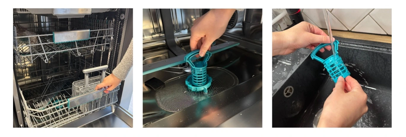

Clean the filter - at least every 2 weeks.
The filter catches all the food debris from your cookware, preventing it from blocking your drains. Over time, this build-up can lead to unpleasant smells and even block water from draining properly. When that happens, your dishwasher may struggle to clean your dishes as thoroughly as it should.
How to clean…
  1. Remove filter unit. This is located at the bottom of the dishwasher.
  2. Rinse under the tap.
  3. Reinstall the filter unit.
Image showing guide to cleaning dishwasher
Ways to reduce how often you must do this…
Scraping your dirty plates or pans before placing them in the dishwasher can reduce the frequency you have to clean the filter.

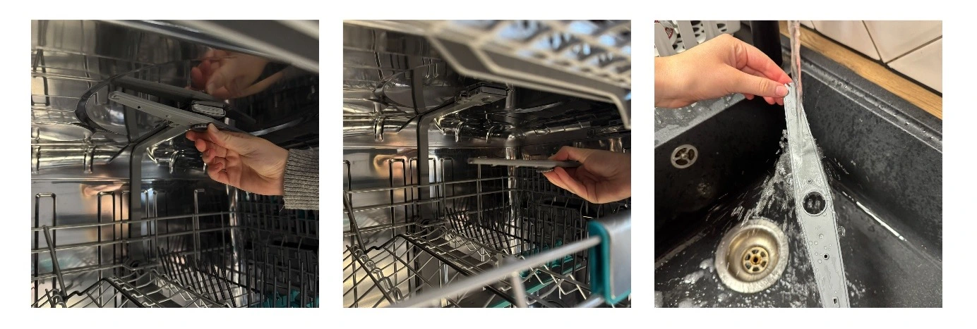

Clean the spray arms - every month
The spray arms, located at the top and sometimes the bottom of your dishwasher, rotate during each cycle to distribute water and ensure every pot, pan, and plate gets a thorough clean. Over time, however, limescale and trapped food particles can clog the tiny spray holes. When this happens, the water flow weakens, and your dishwasher may struggle to deliver the sparkling results you expect.
How to clean…
  1. Remove the baskets.
  2. Unscrew the spray arms.
  3. Clean gently with a brush then use a cocktail stick to unclog the holes.
  4. Spray with a white vinegar solution and leave to soak, if necessary, then clean with soapy water.
  5. Reinstall the arms.

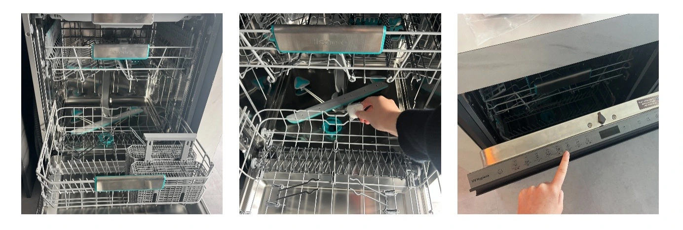

Deep clean your dishwasher - every 3 months
It’s normal for your dishwasher to develop limescale when water leaves behind calcium and magnesium on the surface. Grease can also build up from oils and food residue that cling to the interior during each cycle. Together, these deposits can cause smells and reduce cleaning performance. But completing this clean every few months can get rid of this.
How to clean
Method 1: home-made solutions…
  1. Remove any plates, glasses, cutlery or cookware and complete the above guides to clean the filter and spray arms.
  2. Place a cup of white vinegar in the top basket.
  3. Run hot cycle.
  4. Sprinkle baking soda at the bottom.
  5. Run a short hot cycle.
Method 2: Commercial dishwasher cleaners
  2. Place a commercial dishwasher cleaner into the dishwasher.
  3. Run a hot cycle.
